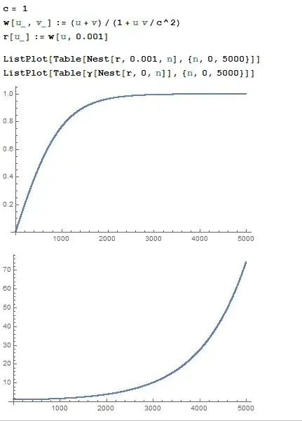

In mathematica I used n=T=3000 and assumed an acceleration of 0.001c/s. This gave me the following graphs, for speed and time dilation as function of (proper) time respectively:
The first looks a lot like the inverse tangent, although I couldn't find any formula of that form to actually fit. Is there actually a way to get a nice formula for either speed or time dilation as function of time?
And just to test the above approach: Imagine travelling in a spaceship accelerating at 10 m/s^2 constantly(a bit more than 1 g), then these graphs represent steps of time of about 300 seconds(time needed to reach 0.001 c classically), so that means that in 5000*300 seconds or about 17 days you should reach that speed as measured on a clock in the spaceship and thus reach a time dilation of about 74, integrating that second graph would then give the time for an outside observer, and would be a lot greater than 17 days. Does this sound reasonable at all?

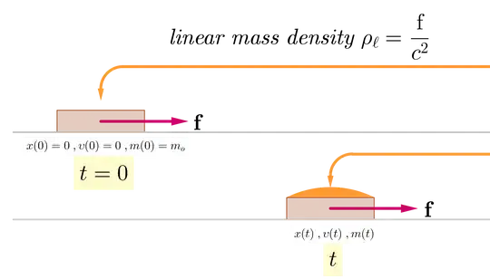

A body of mass $\:m_{o}\:$ initially at rest is moving on a surface without friction under the influence of a constant force $\:\mathbf{f}\:$, as in Figure above. As it is moving, it is carrying away material from a straight line above it. The straight line has a constant linear mass density $\:\rho_{\ell}=f/c^{2}\:$, where $\:\rm{f}\:$ the magnitude of the constant force $\:\mathbf{f}\:$ and $\:c\:$ a quantity with dimensions of speed.
The exercise concerns the determination of the following :
(a) the position $\:x(t)\:$, the velocity $\:\upsilon(t)\:$ and the mass $\:m(t)\:$ as functions of time.
(b) any explicit relation, if there exists, between above quantities.

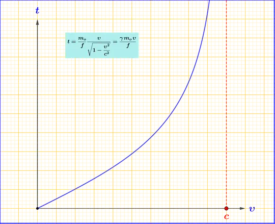

From (04) the time needed to accelerate the body from rest to speed $\:\upsilon$ is :

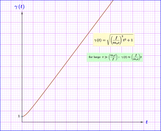

\begin{equation} \boxed{\:\:t=\dfrac{m_{o}}{f}\dfrac{\upsilon}{\sqrt{1-\dfrac{\upsilon^{2}}{c^{2}}}}=\dfrac{\gamma\,m_{o}\,\upsilon}{f} \:\: \vphantom{\dfrac{\frac12}{\sqrt{1-\dfrac{\upsilon^{2}}{c^{2}}}}}} \tag{05} \end{equation} Equation (05) is expressed as : \begin{equation} \dfrac{f\,t}{m_{o}\,c}=\dfrac{\upsilon}{c\sqrt{1-\dfrac{\upsilon^{2}}{c^{2}}}}=\dfrac{\gamma\,\upsilon}{c}=\sqrt{\gamma^{2}-1} \tag{06} \end{equation} From (06), or directly from (04) \begin{equation} \boxed{\:\:\gamma\left(t\right)=\sqrt{\left(\dfrac{f}{m_{o}c}\right)^{\!2}\!t^{2}+1}\:\: \vphantom{\dfrac{\dfrac12}{\dfrac12}}} \tag{07} \end{equation}
For the proper time $\:\tau\left(t\right)\:$ as function of the time $\:t\:$ we have \begin{equation} \mathrm d \tau=\dfrac{1}{\gamma\left(t\right)}\,\mathrm d t =\dfrac{1}{\sqrt{\left(\dfrac{f}{m_{o}c}\right)^{\!2}\!t^{2}+1}}\,\mathrm d t \tag{09} \end{equation} and under the condition $\:\tau\left(0\right)=0\:$ \begin{equation} \tau\left(t\right) =\int\limits_{0}^{t}\mathrm d \tau=\int\limits_{0}^{t}\dfrac{1}{\gamma\left(t\right)}\,\mathrm d t =\int\limits_{0}^{t}\dfrac{1}{\sqrt{\left(\dfrac{f}{m_{o}c}\right)^{\!2}\!t^{2}+1}}\,\mathrm d t =\dfrac{m_{0}c}{f}\sinh^{-1}\left(\dfrac{f}{m_{o}c}\,t\right) \tag{10} \end{equation} that is \begin{equation} \boxed{\:\:\tau\left(t\right) =\dfrac{m_{0}c}{f}\sinh^{-1}\left(\dfrac{f}{m_{o}c}\,t\right)\:\: \vphantom{\dfrac{\dfrac12}{\dfrac12}}} \tag{11} \end{equation} and inversely \begin{equation} \boxed{\:\:t\left(\tau\right) =\dfrac{m_{0}c}{f}\sinh\left(\dfrac{f}{m_{o}c}\,\tau\right)\:\: \vphantom{\dfrac{\dfrac12}{\dfrac12}}} \tag{12} \end{equation} Inserting this expression of $\:t\:$ in (04) we have the following function $\:\upsilon \left(\tau\right)\:$, that is the speed as function of the proper time $\:\tau$ \begin{equation} \boxed{\:\:\upsilon \left(\tau\right) =c\tanh\left(\dfrac{f}{m_{o}c}\,\tau\right)\:\: \vphantom{\dfrac{\dfrac12}{\dfrac12}}} \tag{13} \end{equation}
