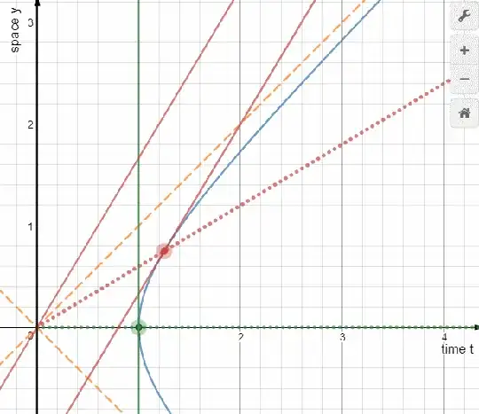

Play around with my simulation (where time runs to the right)
https://www.desmos.com/calculator/awgqxtkqcc
In the way I think about things, I prefer to change units so that I have, effectively, $$s^2=t^2-(y/c)^2,$$ where $c$ is a convenient conversion constant.
Try adjusting the E-slider: E=1 is Minkowski, E=0 is Galilean, and E=-1 is Euclidean in $$s^2=t^2-E(y/c)^2.$$

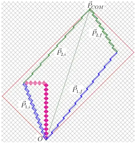

By the way, in the Minkowski case there are still Pythagorean triples... but not in the places a Euclidean would expect. Here are some Pythagorean triples for time-dilation on a spacetime diagram drawn on rotated graph paper. (Update: You can find some more Pythagorean triples in this energy-momentum diagram... You'll have to draw in the legs yourself.)
