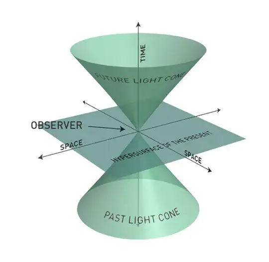

The light cone diagram
Now, what is the geometry behind this whole setup? It's beautifully demonstrated, for example, in this picture from Wikipedia:
Here, the point $x$ is denoted by "observer" and taken as the origin. The set $L$ is depicted by the blue/green (double) cone originating at the origin. The set $T$ is the set of all points inside the light cone(s), both future and past, while the set $S$ describes all points outside of the cone.
Causality
Finally, we remark that the notion of a light cone is intimately related with the notion of causality: Since the light cone represents the maximum distance that light could have traveled from $x$ (in the future part) or the maximum distance from which light could have come to reach $x$ at the moment of time that we have chosen as the $t=0$ plane, it actually tells you that nothing outside of the light cone can be in causal contact with $x$. That is, past events that occurred outside the past light cone cannot have influenced the event $x$, and the event $x$ itself cannot influence any future events that lie outside of the future light cone.
