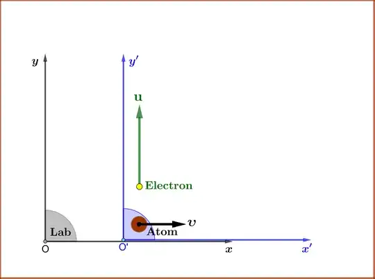

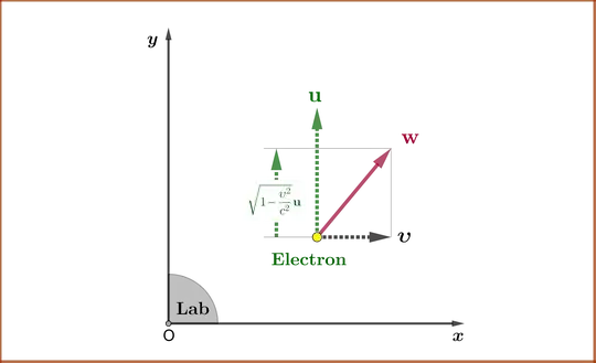

\begin{align} \textrm{velocity of Atom with respect to Lab : } \quad\boldsymbol{\upsilon} & =\left(\upsilon,0\right)=\left(0.30c,0\right) \tag{01}\\ \textrm{velocity of Electron with respect to Atom : } \quad\mathbf{u} &=\left(0,u\right)=\left(0,0.80c\right) \tag{02}\\ \textrm{velocity of Electron with respect to Lab : } \quad \mathbf{w} &=\left(w_x,w_y\right) \tag{03} \end{align}
\begin{equation} \mathbf{w}=\boldsymbol{\upsilon}+\dfrac{\mathbf{u}}{\gamma_{\upsilon}}=\left[\upsilon\,,\left(\!1\!-\!\frac{\upsilon^{2}}{c^{2}}\right)^{\!\!\frac12}\!\!u\right]\,,\quad \gamma_{\upsilon} = \left(\!1\!-\!\frac{\upsilon^{2}}{c^{2}}\right)^{\!\!\boldsymbol{-}\frac12} \tag{04} \end{equation}
EDIT
![![enter image description here
From Figure : Differential expression of Lorentz Transformation from the Atom system $\:\mathrm{S'}\equiv \{x'y't'\}\:$ to the Laboratory system $\:\mathrm{S}\equiv \{xyt\}\:$ \begin{align} \mathrm dx & =\gamma_{\upsilon}\left(\mathrm d x'+\upsilon\mathrm d t'\right)\vphantom{\left(\mathrm d t'+\dfrac{\upsilon}{c^{2}}\mathrm dx'\right)} \tag{01a}\\ \mathrm dy & =\mathrm dy'\vphantom{\left(\mathrm d t'+\dfrac{\upsilon}{c^{2}}\mathrm dx'\right)} \tag{01b}\\ \mathrm dt & = \gamma_{\upsilon}\left(\mathrm d t'+\dfrac{\upsilon}{c^{2}}\mathrm dx'\right) \tag{01c} \end{align} Now, the Electron is moving in $\:\mathrm S'\:$, the rest frame of the Atom, with velocity \begin{equation} \mathbf{u}=\left(\dfrac{\mathrm d x'}{\mathrm d t'},\dfrac{\mathrm d y'}{\mathrm d t'}\right)=\left(0,u\right) \tag{02} \end{equation} To find its velocity $\:\mathbf{w}\:$ in $\:\mathrm S\:$, the Laboratory, we divide (01a) and (01b) by (01c) \begin{align} w_{x} &=\dfrac{\mathrm dx}{\mathrm d t}=\dfrac{\left(\dfrac{\mathrm dx'}{\mathrm d t'}\right)+\upsilon}{1+\dfrac{\upsilon}{c^{2}}\left(\dfrac{\mathrm dx'}{\mathrm d t'}\right)}=\upsilon \tag{03a}\\ w_{y} &= \dfrac{\mathrm dy}{\mathrm d t}=\dfrac{\left(\dfrac{\mathrm dy'}{\mathrm d t'}\right)}{\gamma_{\upsilon}\left[1+\dfrac{\upsilon}{c^{2}}\left(\dfrac{\mathrm dx'}{\mathrm d t'}\right)\right]}=\dfrac{u}{\gamma_{\upsilon}} \tag{03b} \end{align} and finally \begin{align} w_{x} & =\upsilon \tag{04a}\\ w_{y} & = \dfrac{u}{\gamma_{\upsilon}}=\sqrt{1-\dfrac{\upsilon^{2}}{c^{2}}}\:u \tag{04b} \end{align} or \begin{equation} \mathbf{w}=\boldsymbol{\upsilon}+\dfrac{\mathbf{u}}{\gamma_{\upsilon}} \tag{05} \end{equation}
