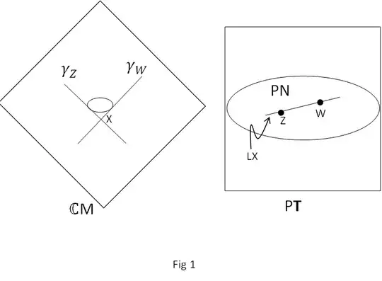

Conversely a point x in real Minkowski space defines a set of null rays – the ones defining the null cone at that point. There is a two-sphere’s worth of such rays (the celestial sphere), and the set of twistors defining these rays defines a subset of $PN$ having the topology of a two-sphere, but more importantly having the complex structure of a $\mathbb{C}P^1$, and known as a projective line (or just “line”). Figure 1 shows a point x in Minkowski space and the corresponding line $L_x$ in $PN$, and also a pair of twistors $Z$ and $W$ on $L_x$ and the null rays $\gamma_Z$ and $\gamma_W$ they correspond to.

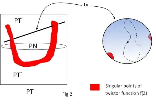

Now the fun starts when you consider functions on twistor space. Suppose we consider a function homogeneous of degree zero (i.e. $f(\lambda Z^{\alpha}) = f(Z^{\alpha}); \lambda \in \mathbb{C}^*$). We then define the field on spacetime: $$\phi_{AB}(x) = \oint{\rho_x(\frac{\partial}{\partial \omega^A} \frac{\partial}{\partial \omega^B}f(\omega^A, \pi_{A’}))\pi_{C’}d\pi^{C’}}$$ where $\rho_x$ means “impose the restriction (1)”. To get a non trivial field, the function f needs to have singularities on twistor space, i.e it mustn’t be holomorphic everywhere. For example it can have poles. The contour used is on the projective line $L_x$ and avoids the singularities of f.
