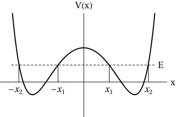

Good question. What you see here is the procedure known as the WKB approximation. Let's start from scratch and proceed slowly. Consider the 1D path integral given by $$Z = \int_{-\infty}^{\infty}\exp(i\mathcal{S}/\hbar)\ \text{dx} = \int_{-\infty}^\infty\exp\left(\frac{i}{\hbar}\int_0^{t_0}\mathcal{L}(x,\dot{x})\text{dt}\right)\text{dx}.$$ Let's look at the Lagrangian closely. Suppose that the Lagrangian has the form $$\mathcal{L}(x,\dot{x}) = \frac{1}{2}m\dot{x}^2-V(x)$$ where the potential looks like two wells stitched together. For visual sake, suppose the potential looks like $$V(x)=\frac{1}{2}(x-L)^2(x+L)^2$$ so that when $x=L$ or $x=-L$ the potential is $V(x)=0$. Graphically, it could look like the following image posted by another physics stack exchange post.

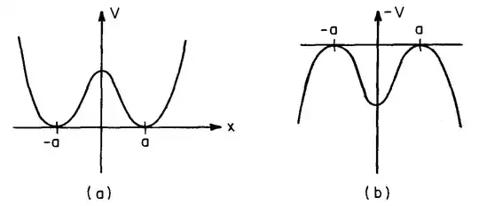

OP's eq. (1) is explained in Ref. 1, or in my Phys.SE answer here. The main points are:
  1. We are calculating the Euclidean ($E$) path integral via the WKB/method of steepest descent $$\begin{align} Z_E~=~&\int_{x(t^E_i)=-L}^{x(t^E_f)=L} \! {\cal D}x~\exp\left\{-\frac{1}{\hbar} S_E[x]\right\}\cr~\sim~& \exp\left\{-\frac{1}{\hbar} S_E[\bar{x}]\right\}\quad\text{for}\quad \hbar\to 0^{+}, \end{align}\tag{A}$$ where $\bar{x}:[t^E_i,t^E_f]\to [-L,L]\subseteq\mathbb{R}$ is the classical path/instanton. (We assume $\bar{x}$ is monotonic and ignore multiple bounce solutions.)
  2. The Euclidean Lagrangian $$L_E ~=~ T + V ~=~ T - (-V) , \qquad T ~=~\frac{m}{2}\dot{x}^2, \tag{B} $$ looks like a standard Lagrangian (i.e. kinetic energy minus potential energy), with apparent potential equal to minus $V$, cf. Fig. 1.
$\uparrow$ Fig. 1. (a) The instanton starts at the minimum $x=-a\equiv-L$ in one well, and tunnels to the minimum $x=a\equiv L$ in the other well. (b) The apparent potential is minus $V$.
  1. The mechanical energy (i.e. kinetic energy plus potential energy) $$ E~\approx~ T + (-V)\tag{C}~\approx~0 $$ is a constant of motion since there is no explicit time dependence, cf. Noether's theorem. The constant $E$ is zero by boundary conditions. (Here the $\approx$ symbol means equality modulo eqs. of motion.)
  2. In other words, $$ T ~\approx~ V\qquad \Leftrightarrow \qquad\dot{x}~\approx~ \sqrt{\frac{2V(x)}{m}} .\tag{D} $$
  3. The Euclidean action becomes $$\begin{align} S_E[\bar{x}]~\approx~&\int_{t^E_i}^{t^E_f} \!\mathrm{d}t^E~ L_E~\stackrel{(B)+(D)}{\approx}~\int_{-L}^{L} \!\frac{\mathrm{d}x}{\dot{x}} 2T\cr ~\stackrel{(B)}{=}~&\int_{-L}^{L} \!\mathrm{d}x ~m \dot{x}~\stackrel{(D)}{\approx}~\int_{-L}^{L} \!\mathrm{d}x ~\sqrt{2mV(x)} ,\end{align}\tag{E} $$ cf. OP's eq. (1).
