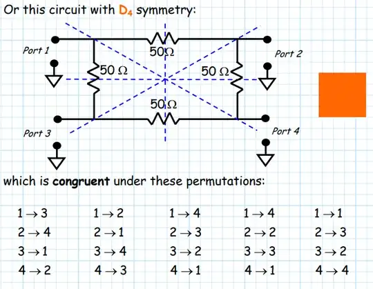

An example from the slide:
I understood it till the 8th slide. Then it goes on to say:

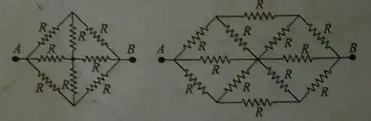

To give a sense of the kind of symmetric circuits I'm dealing with, here are few circuits: enter image description here enter image description here enter image description here

As you add symmetry, different terms end up having to have the same values. This simplifies the set of equations you have to solve to come up with the complete "transfer function" describing the behavior of the circuit. In the notes you quote, they claim (without proof) that when you have D4 symmetry, the scattering matrix reduces to 3 independent variables,
$$S = \left[\begin{matrix}A&B&B&C\\ B&A&C&B\\ B&C&A&B \\ C&B&B&A\end{matrix}\right]$$

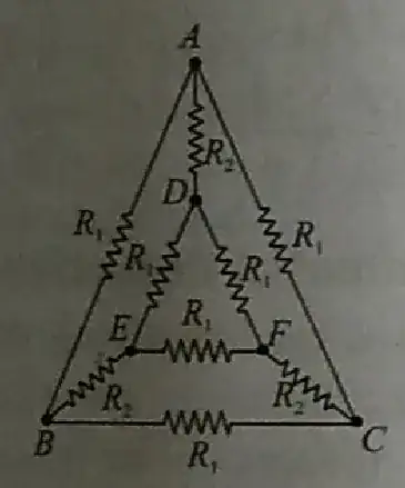

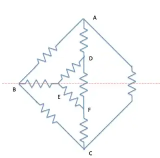

Let's take your pyramid circuit as an example, and let's solve for the resistance from A to C (because of rotational symmetry, AB and BC should give the same result). If I redraw the circuit so A is at the top and C at the bottom
I can see that B and E must be at the same potential (there is "up-down" symmetry for both the network that connects AB and BC, and the network that connects AE and EC). That means we can remove the $R_2$ resistor between B and E, and now we have a set of circuits each of which we can solve:
ABC: just two $R_1$s in series
AC: parallel of $R_1$ and a circuit consisting of AD, DF, and FC in series, where
DF: parallel of 2x $R_1$ in series, and a single $R_1$
Looking at it differently, you can say that $V_{AD} = V_{FC}$ by symmetry, and similarly $V_{AB}=V_{AE}$.
