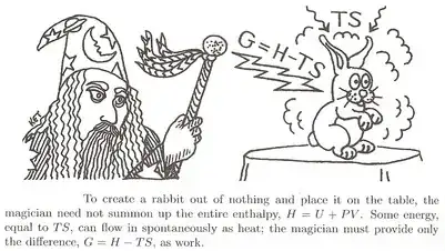

A brilliant analogy by Daniel Schroeder:
  • To summon a rabbit the magician must "build" it with all the energy it consists of. He must provide its internal energy $U$.
  • But first he must push away all the air that is in the way. This requires some work, $W=pV$. In total, the energy he must spend is $U+pV$. Let's call that enthalpy $H$:
$$H=U+pV.$$
  • But the surroundings might help him out a bit. The warm air might provide some energy, while he is working on the summoning, by adding heat $Q=TS$. The only energy he actually has to spend himself is therefore $U+pV-TS$. Let's call this the free energy needed, or Gibbs free energy $G$:
$$G=H-TS.$$

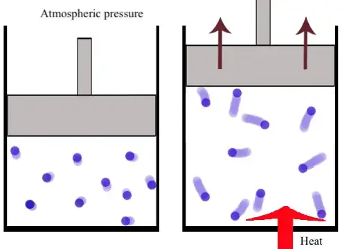

Consider a cylinder containing a certain mass of gas and enclosed by a weightless piston on top.
If you heat the system, the temperature of the gas will rise resulting in an increment in the pressure of the gas. This will cause the piston on the top to rise. The expanding gas will lose some of its thermal energy while doing the above work. Similarly, the volume of the gaseous system increases too. The above two factors would cause the gaseous pressure to ultimately equalize with the atmospheric pressure.
If $\Delta Q$ is the amount of heat added into the gas, $\Delta W$ the work done by the gas, and $\Delta U$ the increment in the internal energy of the gas (which is proportional to the increment in temperature of the gas), then
$$\Delta Q = \Delta U + \Delta W$$ $$\Delta Q = \Delta U + P\Delta V$$ $$\Delta Q = \Delta (U + PV)$$
The change in the '$U+PV$' quantity of the system indicates the amount of heat added to the system.
This '$U+PV$' quantity of the system is what we refer to as the enthalpy of the system.
The change in the enthalpy of the system denotes the heat added to the system.
$$\Delta Q = \Delta H$$
