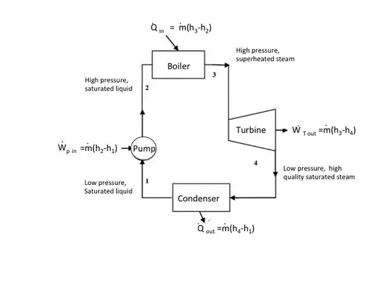

That being said, it is an extremely useful tool for analyzing many open systems. The Wiki statement on enthalpy being the "work required to achieve its pressure and volume" can be illustrated by the Rankine steam cycle. See the diagram below.
The cycle consists of four major components (control volumes): Turbine, Boiler, Condenser, and pump (or compressor). The work associated with the pump and turbine, and the heat transfers associated with the boiler and condenser, can all be expressed in terms of the change in enthalpy of the working fluid (water and/or steam) between the inlet and outlet of each control volume of the cycle. The enthalpies changes include both the changes in internal energy as well as the product of pressure and volume, $\Delta h=\Delta u+\Delta (pV)$, as applicable.
Consider, for example, the pump. The input to the pump (1) is low pressure (generally atmospheric) saturated liquid water that leaves the condenser. To move this low-pressure liquid into the high-pressure boiler (2), the pump needs to increase the pressure of the liquid output of the condenser to force it into the boiler, which then heats the liquid converting it to steam. Since liquid water is relatively incompressible, the work done by the pump consists of constant volume flow work or $Vdp$ work.
