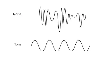

Speech signals are not perfectly sine waves. A pure sound, from a tuning fork would be the perfect sine wave. Regular talking is not a pure sine wave as people don't maintain the same loudness or frequency. As a result, this is what noise looks like, compared to pure frequencies.
Notice the irregularities in the amplitude and the frequency of the noise wave.
