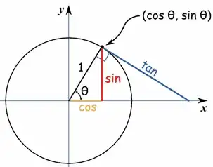

Circles and trig functions are very closely linked, infact trig functions are essentially measurements of the unit circle.
This may help you to visualise:
Unit Circle
There's also a pretty nice Khan Academy section here.
The basic idea is that as you move around the unit circle, you can consider a moving triangle inscribed into that circle, the edges being:
  • A vertical line connecting the point that you're at with the horizontal (conventionally $x$-axis)
  • A horizontal line from that point on the $x$-axis to the origin
  • The hypotenuse connecting your point on the circle to the origin.
The angle in question is the angle between the horizontal line and the hypotenuse. Let's call it $\theta$
If you were to plot out the values of the short sides as you move your point around the circle, starting your point on the positive $x$-axis you'd get a $cos(\theta)$ function for the horizontal and a $sin(\theta)$ function for the vertical.
Effectively the trig functions describe the $x$ and $y$ coordinate of your point.
If you focus your attention on a single axis, say, the $x$-axis it shouldn't be too hard for you to convince yourself that the $x$ coordinate will oscillate.
If instead you were to start your point at some other position on the circle, you'll have a "starting angle" - you can think of this as being some constant offset $\phi$. I.e. you're measuring $\theta$ starting from there instead of starting from 0.
The trig functions are then: $sin(\theta + \phi)$ and $cos(\theta + \phi)$.
An amplitude of anything but 1 is simply a scaled version of the unit circle.
