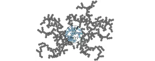

When diffusion is the primary transport mechanism, fractal patterns may arise as the result of diffusion-limited aggregation or more specifically diffusion limited cluster aggregation (DLCA): where the colloidal particles display Brownian motion until they meet and attract, generating clusters of dimension typically between $1.7$ and $1.8$ (though that's also geometry dependent).
When a potential barrier must be overcome in order for the aggregate to form (i.e., the force between the particles is not only attractive), the process is called reaction limited cluster aggregation (RLCA) and leads to more compact clusters, with higher dimensions (e.g., $2.3$).
Image source.
These clusters being fractal means here, essentially, that they are self similar ("look the same") when regarded at different scales (say, $\mu$m, mm, cm, etc.). In the case of colloidal aggregation, that self similarity can come about in the following way: in a first moment, colloidal particles form small clumps, then, these small aggregates form bigger ones, and then these form even bigger ones, and so on.

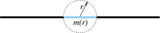

  • Then, consider a tiny volume "in the middle" of the object, for example, a circle of radius $r$, and let it grow;
  • The mass $m$ of the object enclosed by the circle will increase as $r$ grows: if $m$ increases as a power of $r$: $$ m(r)\propto r^d, $$ then you can call $d$ the dimension of the object.
Some examples:
  • For a long straight thread or needle, illustrated bellow, $m$ will grow approximately linearly with $r$, doubling when $r$ doubles, tripling when $r$ triples, and so on: that means $m\propto r^1$, i.e., $d=1$, and we say the object is approximately one dimensional.
  • A sheet of paper of superficial density $\mu$ will present $m=\mu A$, where $A$ is the area of the circle, i.e.: $m=\pi\mu r^2$, i.e., $d=2$ and that's a two dimensional object.
  • Now what happens if we consider that self-similar aggregate? If we measure how much of its mass is enclosed by the circle, we'll find out that $$ m(r) \propto r^{1.7},$$ and we then say that its dimension is $d=1.7$.
