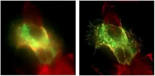

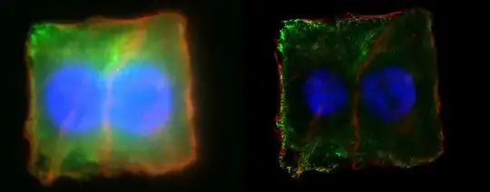

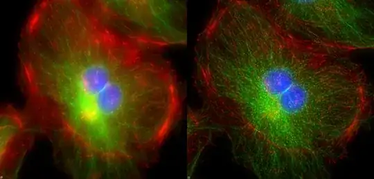

Yes, it's called deconvolution. Here are some examples of deconvolved images from microscopes:
enter image description here enter image description here enter image description here
I found these by Googling for "example of deconvolved image from a microscope".
