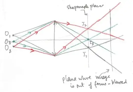

When a sharp image is formed, every point on the object is reproduced in the image, and all the points around that point on the object are reproduced in the same relative positions of the image.
So, a diverging cone of rays from a point on the object hits the lens and the lens then refracts those rays so that they all pass though a point. That point is the image of the point on the screen.
Now suppose you increase the distance between the lens and the screen. Those rays from the object after refraction still converge at the same point as before and then continue onwards as a diverging cone of light that produces a circle of illumination on the screen rather than the point when the image was in focus.
This happens to rays from each point on the object and so these circles of illumination overlap one another and form a blurred image.
Diagram of rays forming a focused and unfocused image
