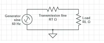

The following is a simple model of a cable and a load:
Simplified model of cable and load
The power delivered to the load is given by
$P_L=I^2R_L$
The power wasted by the transmission cable is:
$P_T=I^2R_T$
The current going through the circuit is:
$I=\frac{V_G}{R_T+R_L}$
We wish to maximize power delivered to the load. Their ratio is simply:
$\frac{P_L}{P_T}=\frac{I^2R_L}{I^2R_T}=\frac{R_L}{R_T}$
And the efficiency:
$\eta=\frac{P_L}{P_T+P_L}=\frac{R_L}{R_T+R_L}$
So to make most power be used in the load, one must simply maximize $R_L$. But doing so would lower the delivered power:
$P_L=\frac{V_G^2R_L}{(R_T+R_L)^2}$
So we need to increase both $V_G$ and $R_L$ to maintain a constant power at the load $P_L$ while minimizing losses. This change in generator voltage and load impedance may both be accomplished by step-up and step-down transformers.
Note: The actual expression for the loss $P_T$ as a function of $V_G$, $P_L$ and $R_T$ is a bit complicated so I thought it's best to leave it out.
