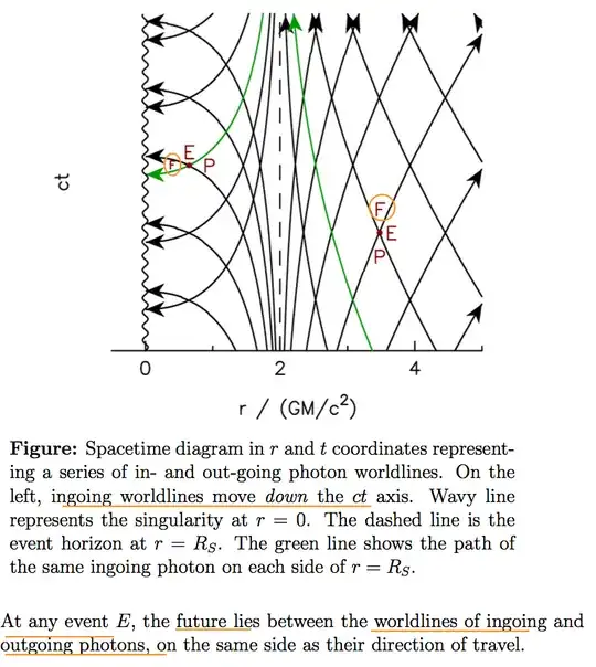

I (kind of) understand that the correct setting for this question is the causal structure of spacetime, something like (from this question)
In Schwarzschild coordinates, if you look at the $g_{tt}$ and $g_{rr}$ parts fo the metric, they flip signs at $r=R_s$. Therefore "inside" the $r$ direction is timelike and the $t$ direction is spacelike. The future-timelike light cone of any event inside the horizon points toward smaller values of $r$.

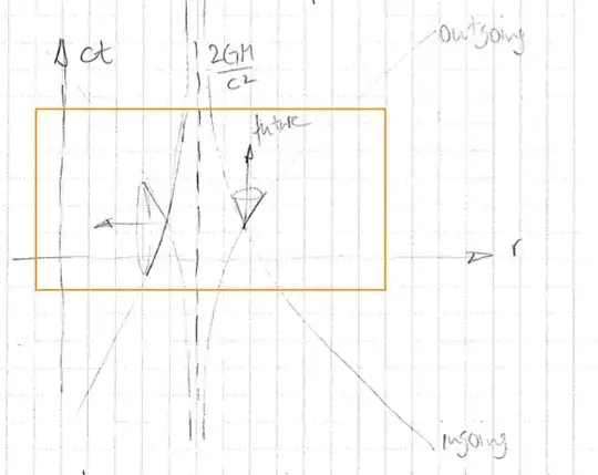

$\partial_t$ is timelike outside and spacelike inside, $\partial_r$ the opposite, good so far. What is the physical, or geometrical, consequence of this? What does it imply for a direction to be something-like?
This answer makes it all about "light cones tilting", but isn't this a frame dependent statement?
Edit: I think this is the core of the question, speaking of causality: how is the "future" defined, with respect to timelike and spacelike directions? Why is the future (F) "on the left" in these picture? enter image description here
There are a few questions in the last part that I realize all boil down to the same concept: what does it mean that "time" and "space" switch role?
