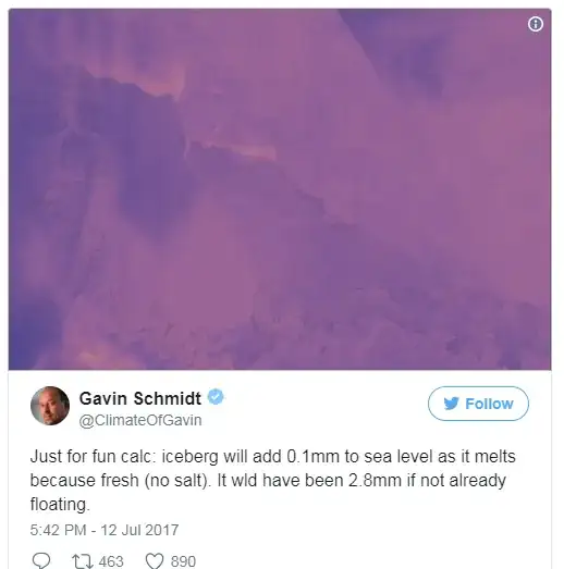

Yes, if an iceberg melts, it will increase the sea level but that increase in sea level is totally negligible. According to this recent article that shows the breaking of Larsen C ice shelf (is considered the largest iceberg crack till date) :
Yes, Sea Levels Will Rise Thanks to the New Iceberg in the Southern Ocean
Scientists estimate that as the ‘iceberg melts, it’ll add about 0.1 millimeters to the total sea level rise. When compared to the rise that NASA and NOAA are already measuring — currently 3.4 millimeters per year — this 0.1 millimeters might seem relatively inconsequential.
If the Larsen C ice shelf, however, was not a shelf — meaning it was on land and not already plopped down in Earth’s ocean — climate scientists like NASA’s Gavin Schmidt estimate the trillion-plus metric tons of ice would have added significantly more water to Earth’s seas, resulting in some 2.8 millimeters of rise. This amounts to over 80 percent of the sea level rise already happening each year.

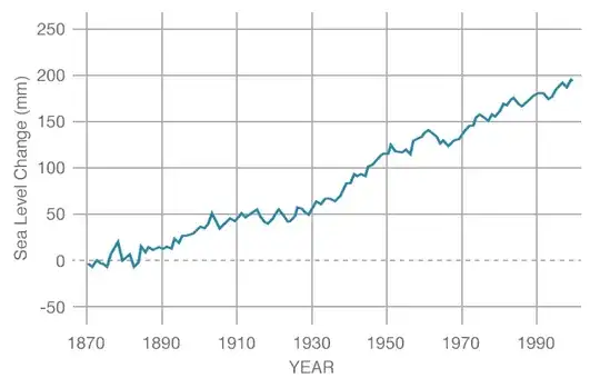

There is also a graph which shows the level of sea rise with time (also from same article):
This likely means that we’re in for some three feet of sea level rise, at minimum, explains Steve Nerem, the lead of NASA’s Sea Level Change Team:
"Given what we know now about how the ocean expands as it warms and how ice sheets and glaciers are adding water to the seas, it’s pretty certain we are locked into at least 3 feet [0.9 meter] of sea level rise. But we don’t know whether it will happen in 100 years or 200 years.”

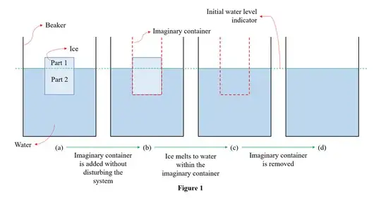

In the analysis of all the four cases, I've added an intermediate step labelled (c) using an 'imaginary container'. This container is introduced to bring out the reason for the difference in the levels of water in cases 2 and 3. This doesn't make any difference in cases 1 and 4.
In step (b), the imaginary container is added without disturbing the system. Then the ice is allowed to melt within the container. After melting, the level of water inside the imaginary container may or may not be the same as that of the outside. Then, in step (d), the imaginary container is removed. Or, for the sake of simplicity, imagine that the imaginary container alone vanishes by some means. The water which was initially inside the imaginary container now mixes with the water outside and the water level of the beaker attains equilibrium. The horizontal green line represents the initial water level in the beaker. Figure 1 is annotated for the reader's convenience.
First, let's consider case 1, where a piece of ice made of pure water floats on pure water in a beaker. As per the Archimedes' principle, the buoyant force on the ice is equal to the weight of liquid displaced by it. Here, the volume of liquid (water) displaced by the ice is equal to the volume of submerged ice (labelled part 2). Weight of the ice, parts 1 and 2 combined, is equal to the weight of water of volume equal to part 2. When the ice of volume parts 1 and 2 melts, the water obtained occupies only volume equal to that of part 2. This is because of the fact ice is less dense than water. The net result is the water level in the beaker remains the same.
Figure 1

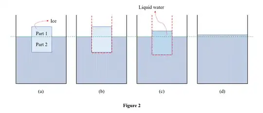

As mentioned in the beginning of the answer, this explanation is based on this answer. Now, let's extend this to other cases. Next on our list is case 2, where a piece of ice made of pure water floats on salt water. We know that salt water is denser than pure water. So the same mass of ice displaces less amount of salt water. Or in other words the submerged volume is less than that of the previous case. The weight of salt water of volume part 2 is equal to the weight of the ice, as per the Archimedes' principle. But, as we allow the ice to melt inside the imaginary container, the water obtained occupies more volume than part 2. This is because pure water is less dense than salt water. This is where the imaginary container helps us to see the difference.
Figure 2
In (c), we can see that the level of water inside the imaginary container is higher than that of the outside. So, when we remove the imaginary container in step (d), the water level in the beaker rises.

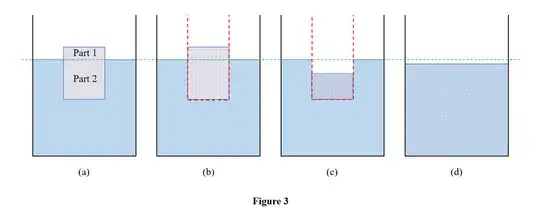

Now, let's move on to case 3, where a piece of ice made of salt water floats on pure water. As the ice made of salt water is denser than the ice made of pure water, it displaces more water compared to the pure ice. Again, as per the Archimedes' principle, weight of ice is equal to weight of pure water of volume part 2. But, this time as the ice melts, the salt water obtained occupies a lesser volume than that of part 2.
Figure 3
In (c) we can see that the level of water inside the imaginary container is less than that of the outside. When we remove the imagniary container in step (d), the water level in the beaker drops. The final case in our analysis is a piece of ice made of salt water floating on salt water. This case is very similar to case 1 and the level remains unchanged.

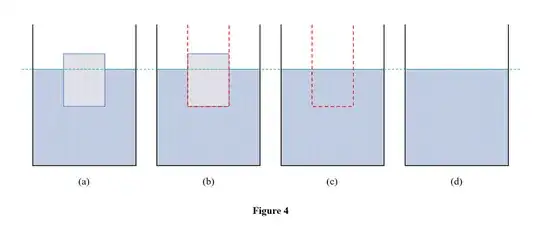

Figure 4
So far we dealt with pieces of ice floating on water in a beaker. Scaling things up, the results obtained here apply to icebergs floating on oceans. As Yashas described, we know from our experience that sea water is salty, and hence only cases 2 and 4 are possible. So, as icebergs melt sea level must either increase or remain the same.
