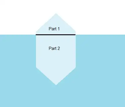

Here is an explanation that needs no explicit equations.
Consider the following diagram, in which part1 and part2 represent the ice.
The displaced water volume equals part2 volume and has as much mass as (part1+part2)
Now look at what happens when both part1 and part2 melt:
- their mass does not change, it is (part1+part2)
- it becomes water.
And we just said that part1+part2 mass water has part2 volume.
