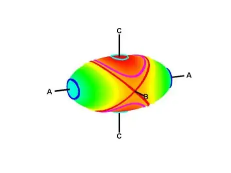

The mathematical explanation for this (see also Wikipedia) is that when considered in the principal axis frame (i.e. the frame of reference that rotates with the body and whose axes are the principal axes of inertia of the body), the motion can be described by the angular velocity $\vec{\omega}$ and the angular momentum $\vec{L}=I\vec{\omega}$, and in the absence of external torques it must conserve the magnitude of the angular momentum, $$L^2=L_1^2+L_2^2+L_3^2$$ (though not its direction since the frame is noninertial), and the rotational energy, $$E=\frac{L_1^2}{2I_1}+\frac{L_2^2}{2I_2}+\frac{L_3^2}{2I_3}.$$
The motion is then constrained to move along the intersections of an ellipsoid and a sphere:
These curves are closed ellipses, or nearly so, close to the axes with the smallest and largest moments of inertia, but they are locally hyperbolae close to the middle one. Hence the instability.
