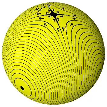

When a rigid body is rotating freely, with no external torques, its angular velocity in body-fixed coordinates follows lines that are the intersection of an ellipsoid and a sphere. (surfaces of constant kinetic energy and constant angular momentum magnitude, respectively.) For initial rotation axes close to the minimum and maximum axes of inertia, the angular velocity circles the axis. But at the intermediate axis the lines cross. There is a saddle point there. Two of the lines point inwards to the centre point, the other two point outwards. The movement slows down the closer you get to the intermediate axis.
Intersections of spheres and ellipsoids
The two lines outgoing from one crossing point are the incoming lines approaching the other crossing point on the opposite side, and vice versa.
We have a number of different trajectories in the neighbourhood. If off to the side of the crossing lines, the rotation axis approaches the intermediate axis, slowing, and drifts off to the side, speeding up. If exactly on one of the inbound pair of lines, the rotation axis approaches the intermediate axis asymptotically, never quite reaching it. If on one of the outbound pair of lines, it moves away from the intermediate axis, speeding up. And if exactly at the crossing point, it stays there. However, any slight perturbation in the direction of the outgoing lines, and it moves away at an accelerating rate.
(You tend to get the rotation hopping from the neighbourhood of one crossing point to the other, pointing in the opposite direction. It quickly approaches the axis along one incoming line, slows nearly to a halt, appearing to wait there for a while, then accelerates away and closes in on the opposite axis, where it waits again.)
It is like balancing a ball on a saddle point. It is considered unstable because virtually any perturbation you can make will result in divergence. If it is pushed away exactly along the line joining the two peaks, it will get pushed back, but any perturbation from that precise ridge line will be unstable.
