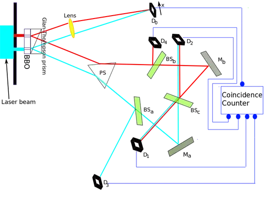

The experiment of Kim et al. (Phys. Rev. Lett 84, 1 (2000), arXiv:quant-ph/9903047):
Image source
Distribution of signal photons at $D_0$:
Image source
(signal photons are the ones going through the yellow lens and idler photons are the ones going down)

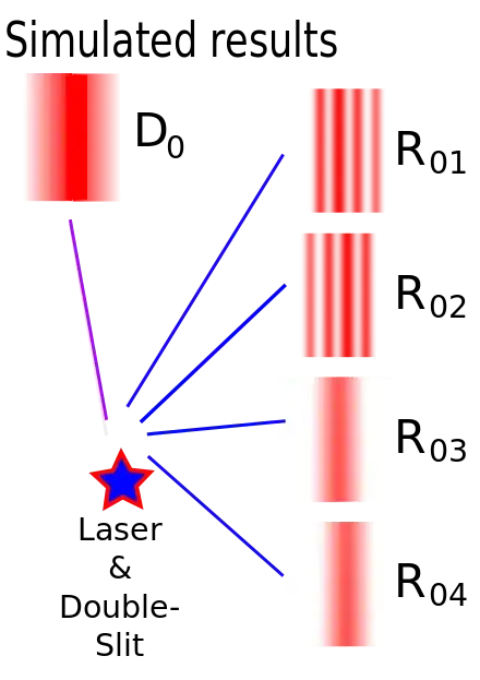

The wikipedia page states "The total pattern of signal photons at the primary detector never shows interference" (primary detector is $D_0$)
We must sort the signal photons into four streams that reflect the states of the idler photons at their four distinct detection screens in order to isolate the interference pattern or no-interference pattern. ($R_{01}$, $R_{02}$, $R_{03}$ and $R_{04}$ are simulated distinct detection screens)
Would the isolated patterns $R_{01} + R_{02}$ equal $R_{03} + R_{04}$?

In a word, yes. The interference fringes in $R_{01}$ and $R_{02}$ are offset by half a fringe spacing, in such a way that if you add the two, the fringes get completely erased, and the pattern matches exactly what you get if you add together the two complementary non-interfering patterns.
Pulling the plots from this later answer, this is what a realistic set of distributions looks like for the Wikipedia standard setup:
Both $R_{01}+R_{02}$ and $R_{03}+R_{04}$ add up to $D_0$.
