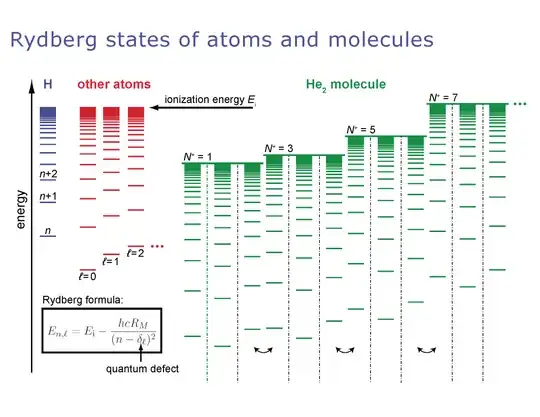

Rydberg states form an infinite series of electronic states that asymptotically approach the ionization potential of the atom or molecule, usually in good agreement with the simple Rydberg formula.
Image source
