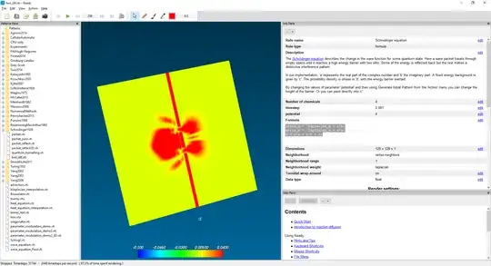

Excellent question, I have a similar mindset having studied similar subjects. The cellular interpretation of differential equations really helps me develop intuition and play around with them.
You are looking for a continuous cellular automaton formulation, which can also be interpreted/implemented as a reaction diffusion-system with n-"chemicals" or vector components (one for each continous variable).
Check out the https://github.com/GollyGang/ready framework which was developed for studying exactly these types of systems - the included example Schroedinger1926/two_slit.vti is exactly what you are looking for enter image description here here is a movie: https://www.youtube.com/watch?v=te_JU3RZ2eM&ab_channel=TimHutton
A fairly stable rule (I think this is probably a second order (leapfrog integration) scheme) is used: You need 4 real components (called "chemicals" in ready) a,b,c,d at each point in space and update them according to:
delta_a = -laplacian_b - c*b;
delta_b =  laplacian_a + c*a;
d = a*a + b*b + c;
The authors write
In our implementation, 'a' represents the real part of the complex number and 'b' the imaginary part. A fixed energy background is given by 'c'. The probability density is shown in 'd', with the energy barrier overlaid.
Other rules might be stable with bigger timesteps or more simulation steps - your mileage may vary. The examples under NumericalMethods give a quick overview of available low-order integration schemes, each with vastly different stability after tens of thousands of timesteps.
