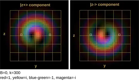

Since Emilio Pisanty didn't seem convinced by this answer, I decided to try to confirm this analysis by a completely different approach. I wrote a program that numerically simulates the Schrodinger equation on a y-z grid for the Hamiltonian being discussed here. The code is here on github. The Hamiltonian is the same as in Bohm, except that where Bohm ignores both the x and y coordinates, I only ignore x, and I include the gradient of the magnetic field in the y direction, which has to exist by Gauss's law. Some results are shown below for a case where $B=0$ but $k\ne0$, which is the main case of interest in this question. The distance units are such that each square is 2 units by 2 units. The other units are such that $\hbar=1$, the mass of the electron is 1, and the magnetic dipole moment of the electron is 1 (not -1). In these units, the output below has $k=\partial B_z/\partial z=300$. The wave packet is initialized as a Gaussian profile with an rms of 0.15 distance units. In this particular simulation, I used a beam polarized along the x axis. The grid for the numerical computation is 41x41, shown as 41x41 pixels below. The boxes superimposed for reference are 5 pixels square, and are offset by 0.5 pixels to the right and 0.5 pixels downward from the center, so that the lines lie on the boundary between pixels.
simulation of Stern-Gerlach experiment
Here's how to interpret this diagram. Each box shows one spin component of the wavefunction, in the z basis. The left side is |z+>, the right |z->. The axes are y and z, as labeled. You have to imagine the two squares superimposed on each other. The amplitude of the wavefunction, with an arbitrary normalization, is indicated by brightness, and the phase by a cyclic colormap defined in the legend on the diagram.
It looks to me like this mostly confirms my original pen-and-paper analysis and my interpretation of that analysis. As predicted, we get a ring on the detector. As predicted, particles observed on the positive z axis are polarized as |z+>, those on the negative z axis as |z->, those on the positive y axis as |y->, and those on negative y as |y+>. It's easy to verify the ones on the z axis: there is appreciable amplitude only for one component or the other in the z basis. For the y, you have to look carefully at the phase relationship between the two graphs. To help in doing this, I've selected two points and drawn white boxes around them. The one on the right is yellow for |z+> and red for |z->, which means that, ignoring normalization, it equals approximately i|z+>+|z->. Ignoring an arbitrary phase, this is the same as |y->. A similar analysis for the point selected on the left shows that it is is i|z+>-|z->, which is |y+>.

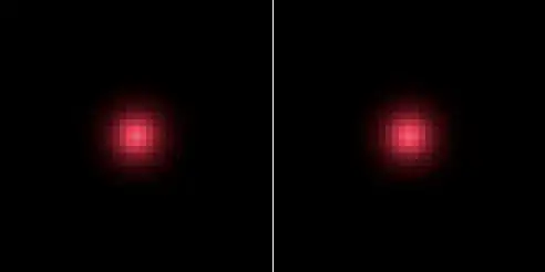

Here are a couple more plots for comparison. The initial wavepacket is polarized along the x axis, and you can see that because the red color for both components indicates that its wavefunction is of the form |z+>+|z->:
initial wavefunction

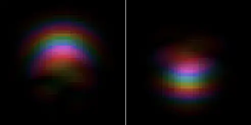

Here is the final state of a simulation under conditions more like those of the historical Stern-Gerlach experiment, with $B=300$ and $k=300$:
simulation with nonzero field
This is pretty much what we expect to see. The beam splits into two wave packets, one heading up and one heading down. The rainbow stripes show the character of a complex exponential $e^{\pm iz}$. The wavepackets' rms radii have grown somewhat, which makes sense due to dispersion.
