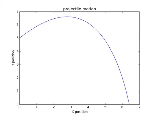

print('Total flight time: %.3f sec\n'%t)
print('Total distance: %.2f m'%X[-1])
print('Initial horizontal velocity: %.2f m/s'%vx_init)
print('Final horizontal velocity: %.2f m/s'%vx)

And an example of the output of the above:
