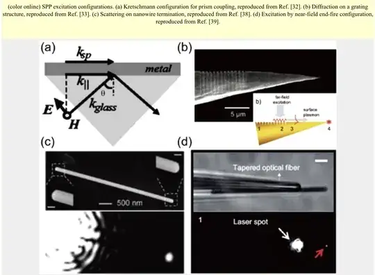

The electron - as well as a photon - that passes through the slit, couples to the surface electrons of the slit edge(s). In principle, this is one of the technologies of spin electronics. The incoming radiation couples to a solid. At the end of the solid, the coupling reverts to energy of the outgoing radiation. This manipulates the direction of the outgoing radiation (electrons, photons). The main thing is to focus the radiation. enter image description here
Source: Yang Longkun, Li Pan, Wang Hancong, Li Zhipeng. Surface plasmon polariton waveguides with subwavelength confinement
If the deflection of the electrons (leading to an intensity pattern on a screen) has to do with the coupling to the surface of the slit, then the manipulation of the edge electrons by plasmons or phonons changes the deflection. Thermal radiation up to a certain intensity, on the other hand, has no effect on the interactions at the edge. Thermal radiation would induce neither plasmons nor phonons. This is the reason why the fringe pattern remains undisturbed by the impact of electrons.
