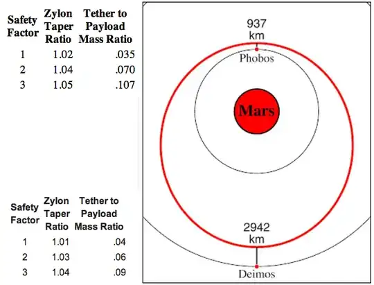

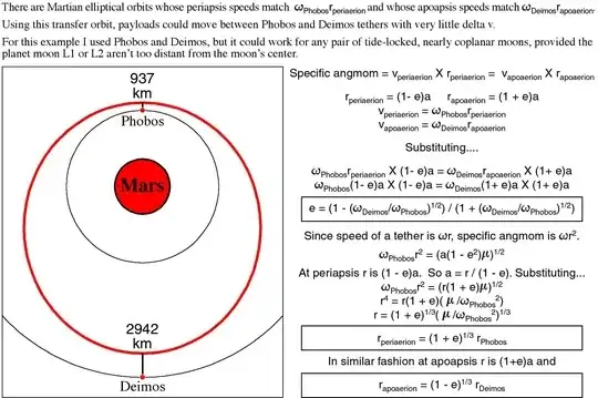

I am excited about elevators allowing a Zero Relative Velocity Transfer Orbit (ZRVTO) between Phobos and Deimos:
Taper ratios and tether to payload ratios for these two elevators are quite modest:
Extend the upper Phobos elevator and you can fling payloads to the Main Asteroid Belt as well as towards earth. And without prohibitive tether to payload mass ratios.
Extend the lower Phobos elevator 1400 kilometers and you can drop payloads into orbits where periapsis passes through Mars' upper atmosphere. A few periapsis drag passes can circularize at low Mars orbit with a velocity of about 3.4 km/s. EDL would be easier than the 5.5 km/s atmospheric entry a payload incoming from an earth to Mars Hohmann would experience. Especially if the descent vehicle had some propellent and reaction mass from Phobos. Mars EDL could be considerably easier. Given a safety factor of three, tether to payload mass ratio would be .33.
