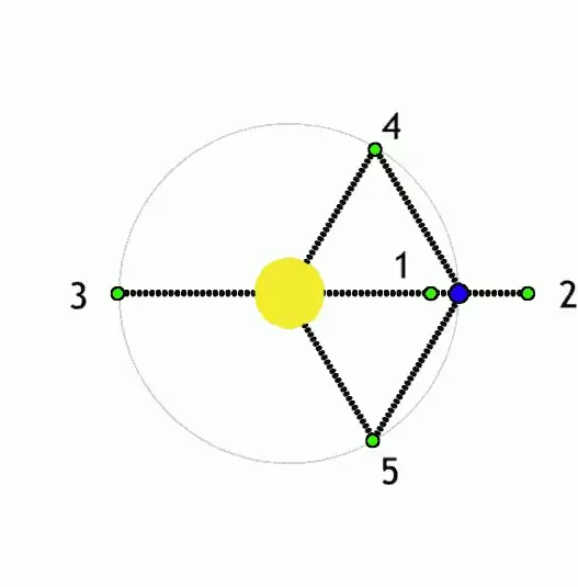

Then we remember that there are 5 points - the Lagrangian points, where objects remain stationary with respect to planet and the star. Taking the image from wikipedia Lagrangian points
If the planet is tidally locked to the sun the Lagrangian points are also stationary from the point of view from the surface! Then we may build a space elevator connecting the tether to an asteroid located in one of the Lagrangian points. The most obvious choice are L1 or L2. However these Lagrangian points are unstable and our asteroid would tend to leave them thus requiring constant corrections of its orbit. From this point of view the stable points L4 and L5 seem more favourable. Of course they are much farther from the planet and this may compensate this advantage completely.
