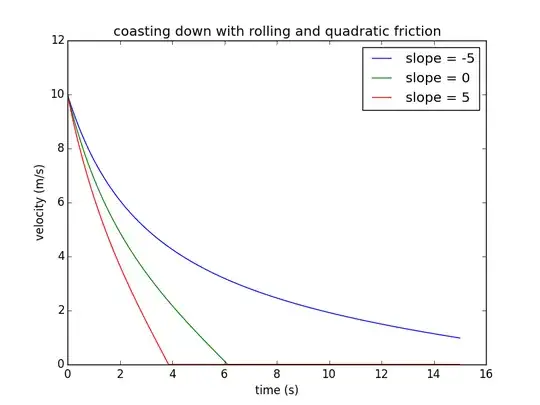

Just to check that things work as expected, I wrote a quick Python program that computes the velocity according to the above expression, incorporating also the effect of slope (note - if the slope is such that the object would accelerate, you get a "math domain error". This is not a hard thing to fix, but it would make the code more complicated to read, so I left that out for now.)
Running the code with three values of slope (where negative slope = downhill) gave the following plot; you can see that the slope of -5° almost exactly cancels the rolling resistance of 0.1 (arcsin(0.1) = 5.7°), leaving just the quadratic drag; if you set the quadratic drag coefficient $C_ad$ to zero, the velocity ends up almost completely unchanged. So yes, this is believable.
