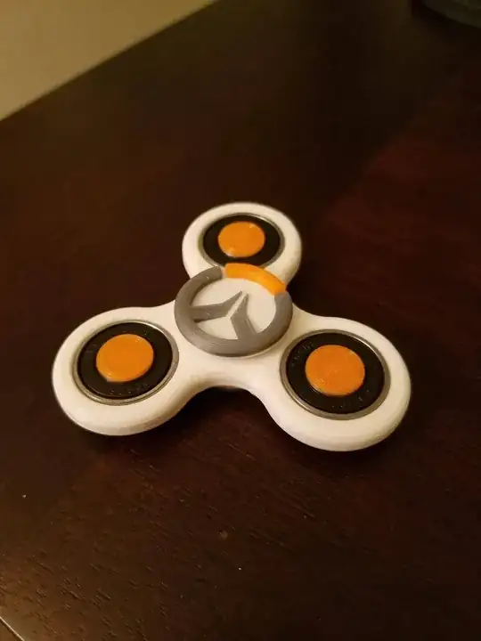

So "fidget spinners" are now massively popular. I got one, and it occurred to me that I'm not sure which force is more important in slowing them: friction in the bearing, or air resistance acting on the arms. Picture included for reference. One holds it in the center, and spins the three-armed piece. Since the type of bearing is important for this question, let's assume a high-quality ceramic silicon nitride 608 bearing.
