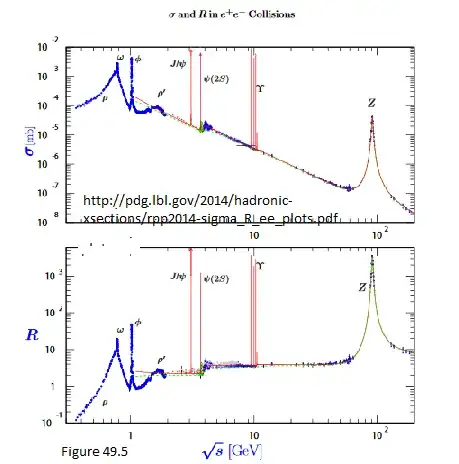

Here is the crossection of e+e- scattering ( see link for details) showing the resonances seen.
e+e-
The effect of the propagator accompanying a virtual particle is seen clearly. At the mass of the Z there would be a delta function except for quantum mechanical indeterminacy, but there is a contribution of a Z virtual exchange ( we only see the external lines of the Z decay) even far off the mass of the Z. It does not turn into something else. Far away from the mass value of the peaks, the contributions of all these resonances add up, except they become fast very small. There is no confusion of masses.( I have used the Z as an example because it is an elementary particle, but resonances also like j/psi and rho etc can be mathematically described with a virtual line and a propagator).
