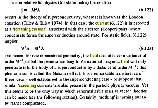

A quick answer: "screening" currents in the superconductor are proportional to the vector potential. With an appropriate choice of gauge, the screening current appears as a mass term in the wave equation for the vector potential. From "An Informal Introduction to Gauge Field Theories":
(This excerpt from Google books)
