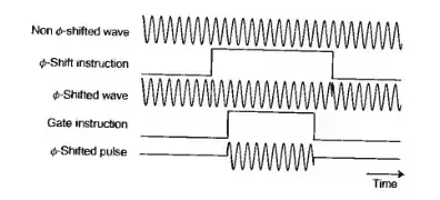

As I pointed out in the comment below, this is not unphysical per se, but can accommodate a phase shift between two pulses that is, for instance, imposed by shift of the phase of the radiation field,
phase shifted pulse
which can't be described by a Hamiltonian anyway. A inclusion of such a phase shift may seem unphysical for not yielding the identity transformation for $t \rightarrow 0$, but it can't be described by a Schrödinger equation anyway but should be considered as a kind of external condition.
