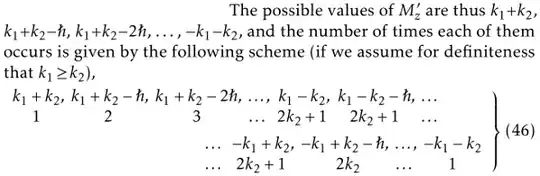

Reading Dirac's Principles of Quantum Mechanics, I encounter in ยง 36 (Properties of angular momentum) this fragment:
This is for a dynamical system with two angular momenta $\mathbf{m}_1$ and $\mathbf{m}_2$ that commute with one another, and $\mathbf{M}=\mathbf{m}_1+\mathbf{m}_2$. $k_1$ and $k_2$ are the magnitudes of $\mathbf{m}_1$ and $\mathbf{m}_2$, so the possible eigenvalues of $m_{1z}$ are $k_1$, $k_1-\hslash$, $k_1-2\hslash$, ..., $-k_1$, and similarly for $m_{2z}$ and $k_2$.
The question is about the two $2k_2+1$ terms shown in the second line of eq (46). Shouldn't the last one be $2k_2+2$?

I think $2k_2 + 1$ is correct. If you write down the pairs of $k_{1z}$ and $k_{2z}$ they are:
  • ($k_1 - 1$, $-k_2$)
  • ($k_1 - 2$, $-k_2 + 1$)
  • etc
  • ($k_1 - 2k_2$, $k_2 - 1$)
  • ($k_1 - (2k_2+1)$, $k_2$)
So that's $2k_2+1$ of them.
