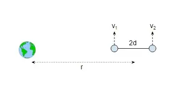

Consider the extreme case of a dumbbell made from two point masses and in orbit round the Earth:
Dumbbell in orbit
If the centre of mass is a distance $r$ from the centre of the earth then the orbital velocity of the dumbbell as a whole is:
$$ v = \sqrt{\frac{GM}{r}} $$
However the inner mass is closer to the Earth at a distance of $r-d$ and the outer mass is farther away at a distance of $r+d$. That means the velocities the two masses want to orbit at are:
$$ v_1 = \sqrt{\frac{GM}{r-d}} $$
and:
$$ v_2 = \sqrt{\frac{GM}{r+d}} $$
so $v_1 \gt v_2$. That means the dumbbell will rotate as it orbits.
This is something of an extreme example, and I suspect you were thinking of some object falling radially rather than orbiting, but the same argument applies. Since different parts of the object will be at different distances from the centre of the Earth they will experience different forces. If these forces exert a net torque then the object can rotate as it falls.
