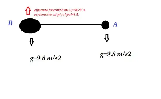

The rod doesnot rotate because 1) both the mases (heavier mass B and smaller mass A on both ends )move down with same acceleration,so they dont rotate. 2)and you asked the question if you take the pivot point at centre of mass there is no torque and if you take other end as pivot then you got confused ,but the other pivot point (A) is not stationary and accelerating so its in non inertial frame,so if you calculate in non inertial frame then you should add pseudo force in the opposite direction at mass B so you get again resultant torque=0. I think your doubt is solved.enter image description here
