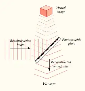

Wikipedia has an image that mentions reconstructing a virtual 3d object:
Some problems that that image, though, is that my credit card:
  • has no reference beam
  • is not being viewed at a 45 degree angle (meaning no interference can happen)

...my credit card:
Well, first about interference. I think you misunderstand what does "interference" mean in that context. We are talking about wave interference between object wave and reference wave. The hologram records interference pattern, that is produced by wave interference of the two waves. And all that is relevant during creation of a hologram.
The interference patterns are very fine -- they are of a size of a wavelength. So there is a lot of information recorded on the hologram -- that is how all that information "fits" on one hologram.
Finally. When we reconstruct a hologram we use a reference beam, which diffracts on the recorded interference patterns and reproduces the object wave.
