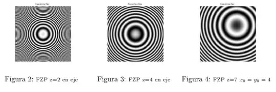

This functions are called sinusoidal Fresnel Zone Plates and they look like this:
The center of the FZP specifies localization of the point source: $x_0$ e $y_0$. Spatial variation of the FZP is governed by a sinusoidal function with a quadratic spatial dependence. Now let's place the point source on-axis: $x_0=y_0=0$, at some distance $z_0$ from the plate: $$ t(x,y) \propto |\psi_0^2 +\psi_r^2|^2 $$ $$ =\left|a + \frac{i k_0}{2 \pi z_0} \exp(-i k_0 (x^2+y^2) / 2 z_0)\right|^2 \\= a^2+\left(\frac{k_0}{2\pi z_0}\right)^2 + \frac{k_0}{2\pi z_0} \sin\left(\frac{k_0}{2 z_0} [(x^2+y^2)] \right)\\ =FZP(x, y;z_0) $$

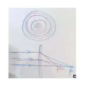

We can see how the holographic record presents a lens structure. Focal distance is parametrized by spatial frequency of incoming FZP. This systems records on a bi-dimensional surface differences between the FZP that conform our object (since any object can be decomposed as a collection of point sources).
Please note here is the answer to your question:
*Different FZP's have different spatial frequencies according to their distance to the plate. This information is encoded in the hologram and revealed upon illumination. The coding consist of a parametrization of different lenses (focal distances) according to the distance of the individual point-sources which make up the object.

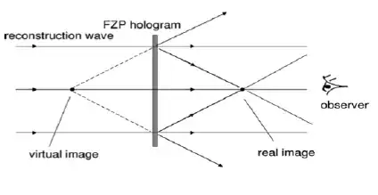

  • Visualization of the hologram
In order to recover the hologram, we simply need to illuminate the plate with the same reference wave. Let's call it reconstruction wave, whose value at the plate is: $\psi_{rc}=a$ ($z_0=0$) Transmitted field distribution after the hologram will be:
$$\psi_{rc} t(x,y)=a t(x,y)$$
Finally, the field at distance $z$, according to Fresnel's diffraction:
$$ a t(x,y) \ast h(x,y;z) $$
$$ = a\left[ a^2+\left(\frac{k_0}{2\pi z_0}\right)^2 + \frac{k_0}{4 i\pi z_0} \left( e^{\frac{k_0}{2 z_0} [(x^2+y^2)]} - e^{-\frac{k_0}{2 z_0} [(x^2+y^2)]} \right) \right] \ast h(x,y;z) $$
Now we can take advantage of the fact that convolution is a linear operator and the field finally decomposes in the following terms:
zero order (This gives some noise)
\begin{equation} a \left( a^2 + \left( \frac{k_0}{2\pi z_0}\right)^2\right) \ast h(x,y;z) \end{equation}
real image (pseudoscope) (reversed-phase object information)
\begin{equation} \sim e^{-\frac{i k_0}{2 z_0} [(x^2+y^2)]} \ast h(x,y;z=z0)= \end{equation} $$ e^{\frac{i k_0}{2 z_0} [(x^2+y^2)]} \ast e^{- i k_0 z} \frac{i k_0}{2 \pi z_0} e^{\frac{-ik_0(x^2+y^2)}{2z_0}} \sim \delta(x,y) $$
virtual image (orthoscope) ("in-phase" object information)
\begin{equation} \sim e^{-\frac{i k_0}{2 z_0} [(x^2+y^2)]} \ast h(x,y;z=-z0)= \end{equation} $$ e^{\frac{-i k_0}{2 z_0} [(x^2+y^2)]} \ast e^{- i k_0 z} \frac{i k_0}{2 \pi z_0} e^{\frac{-ik_0(x^2+y^2)}{2z_0}} \sim \delta(x,y) $$
In the last term, we have propagated in inverse direction the field immediately anterior to the plate to demonstrate that a virtual image will emerge behind the hologram. This is the wave that preserves the orientation of the object's wave phase. The real part provides this information in reverse order, that is why it's called pseudoscope term. Off-axis architecture eliminates this placing object and plate at different directions.
