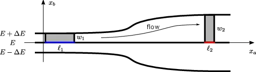

Hamiltonian flow of small volume in phase space, with changing "side" length along energy hypersurface.
I was trying to understand this today and I appreciated the advice to refer to Khinchin's very clear analysis. I made a picture (above) that helped me see the key qualitative idea.
Consider a small volume of phase space trapped between two energy hypersurfaces, evolving with the Hamiltonian flow. Liouville's theorem tells us that the Lebesgue measure of the two volumes shown, $V_1 = \ell_1 w_1$ and $V_2 = \ell_2 w_2$, are equal. The $x_a$ coordinate in the picture represents all $6N-1$ dimensions of the energy surface $H^{-1}(E)$, while $x_b$ represents a single direction normal to the energy surface.
Since the dynamics of a time-independent Hamiltonian system with energy $E$ is constrained to the energy surface, we are interested in defining a measure on that $6N-1$-dimensional space that is invariant under the flow. But as can be seen in the schematic (blue vs. red strokes), the area on that surface is not invariant: $\ell_1 \ne \ell_2$.
Instead we can use the fact that, for small $\Delta E$, $w_i = \left.\frac{{\rm d} x_b}{{\rm d}E}\right|_i \,\Delta E$, and therefore: \begin{align} \ell_1 w_1 &= \ell_2 w_2\\ \ell_1 \left[ \left.\frac{{\rm d} x_b}{{\rm d}E}\right|_1 \,\Delta E\right] & = \ell_2 \left[\left.\frac{{\rm d} x_b}{{\rm d}E}\right|_2 \,\Delta E\right]\\ \frac{\ell_1}{\left. \frac{{\rm d} E}{{\rm d}x_b} \right|_1} &= \frac{\ell_2}{\left. \frac{{\rm d} E}{{\rm d}x_b} \right|_2}\\ \frac{\ell_1}{\left|\nabla H\right|_1} &= \frac{\ell_2}{\left|\nabla H\right|_2} \end{align} So, in this simplified schematic, phase space volume preservation due to Liouville implies preservation of $\int \frac{{\rm d}\sigma}{|\nabla H|}$.
