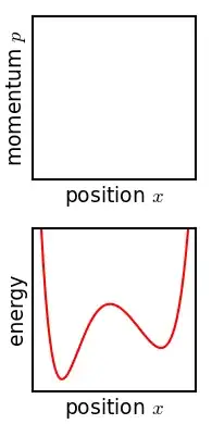

I made an animation for wikipedia that might help:
Animation of phase space evolution
The upper plot shows a 2D phase space (the phase space "volume" is the displayed area; a constant-energy surface would be a 1D curve). The mechanics are simply that of a particle moving in the potential well plotted in red on the bottom graph.
The ensemble of blue phase points is a volume ensemble. Oberve the green point in particular. Notice how the phase points slow down on the left side of the well where $|\nabla H|$ is lower, and speed up on the steep potential slope on the right side.
Now back to the constant-energy Liouville's theorem. The whole point is we want a measure where the phase area is conserved in evolution. We thus need to compensate for the tendency of phase points to vary their phase space speed.
