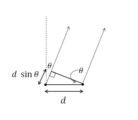

Case 1: Two Point Sources
Before we answer what happens with infinitely many wavefronts, it'd make sense to ask what if we have two point sources?
Two Point Sources
Given a point on the screen ahead, what is the straight path from one of the sources to that point? Since the screen is far away, we approximate these two paths to be parallel, as given by the two arrows in the image. The only difference between these two paths here is that one of them is longer by $d\sin\theta$.
We're dealing with 2D waves where they spread out in a circle from each source, but along each line we essentially have a 1D wave. In the picture above, if $x$ is the distance along one of the arrows, the wave is given by $A\sin(kx-\omega t)$. If the right arrow has total distance $x=D$, the left arrow has total distance $x=D+d\sin\theta$ (all that matters is that if you draw a really long triangle, the two longest sides would differ by about $d\sin\theta$).
At the screen, the wave due to the right source is $A\sin\big(kD-\omega t\big)$. The wave due to the left source is $A\sin\big( k(D+d\sin\theta)-\omega t \big)$. Therefore, our total wave is
$$ A\sin\big(kD-\omega t\big) + A\sin\big( k(D+d\sin\theta)-\omega t \big). $$
To clean this up a little, let $\phi = kD-\omega t$ and let $\Delta\phi = kd\sin\theta$. This gives the expression
$$ A\sin(\phi)+A\sin(\phi+\Delta\phi). $$
This sum of sines is actually just a single sine wave in disguise! We have to use some non-trivial trig identities. This one is given on Wikipedia in the section called "Linear combinations". Then
$$ A\sin(\phi)+A\sin(\phi+\Delta\phi) = \underbrace{\sqrt{A^{2}+A^{2}+2A^{2}\cos(\Delta\phi)}}_{\text{Amplitude}}\sin(\cdots). $$
The amplitude (using the half-angle formula) is given as
\begin{align*} \sqrt{2A^{2}+2A^{2}\cos(\Delta\phi)} &= A\sqrt{2}\sqrt{1+\cos(\Delta\phi)} \\ &= 2A\sqrt{ \frac{1+\cos(\Delta\phi)}{2} } \\ &= 2A\cos(\tfrac{\Delta\phi}{2}). \end{align*}
Ooookay. One more thing. If we back up, we need to clarify that $k$ is called the wave number. It is related to wavelength by $k = 2\pi/\lambda$. With this, we know $\Delta\phi = kd\sin\theta = 2\pi d\sin\theta/\lambda$. Therefore, the wave is $2A\cos\left(\frac{\pi d\sin\theta}{\lambda}\right)$. The intensity is given by the square of the amplitude, so $$ I(\theta) = 4A^{2}\cos^{2}\left(\frac{\pi d\sin\theta}{\lambda}\right). $$

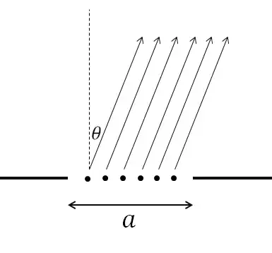

Case 2: Single-Slit Pattern
The above was given just so that we have the general approach to looking at these problems, so you can attack the problem where you have three point sources or $N$ many, and this will be useful here.
We have a single slit of width $a$. The strategy is to split the wave into $N$ waves in the spirit of Huygens. The wave sources are equally spaced out by $\Delta s = a/N$. Each wave source contributes $1/N$ of the original wave.
Single-Slit
This will mirror the reasoning employed for the case of two-point sources. Let $D$ be the distance between the exact center of our slit to the target. The distance from each point to the target is then $x = D + s_{n}\sin\theta$ where $s_{n}$ is the position of the source relative to the center (if the source is farther to the right, $s_{n}$ shall be greater).
The wave due to each source is now $(A/N)\cos\big(k(D + s_{n}\sin\theta) - \omega t \big)$. Since we already noted $\Delta s = a/N$, we have $\Delta s / a = 1/N$. Summing up all the waves, we have
$$ \sum_{n} A\cos\big(k(D+s_{n}\sin\theta) - \omega t \big)\frac{\Delta s}{a}. $$
We are now going to use a trick. The trick is to take advantage of Euler's identity $e^{iu} = \cos(u)+i\sin(u)$. This will seem cheap, but we will simply replace all of the $\cos u$ terms by $e^{iu}$, and we will understand that we're dealing only with the real part when necessary.
The key to this is that the "real part" is additive, so $\text{Re}\; (e^{iu}+e^{iu'}) = \text{Re}\; (e^{iu}) + \text{Re}\; (e^{iu'})$. This kind of property does not hold if we are multiplying complex numbers, and this only works because we are adding things. Also, what we're doing respects integration, so $\int_{a}^{b} \text{Re}\;e^{iu}\;du = \text{Re}\;\int_{a}^{b}e^{iu}\;du$. The magic of this trick is that it makes all of the trigonometry significantly easier to deal with.
We are going to go back to the sum above and write
$$ \sum_{n} Ae^{i\left[ k(D+s_{n}\sin\theta)-\omega t\right]} \frac{\Delta s}{a}. $$
Huygens's principle deals with infinitely many wavefronts. This means we are meant to send $N\rightarrow \infty$. The above sum then transforms into
\begin{align*} \int_{-a/2}^{a/2} \frac{A}{a}e^{iks \sin\theta} e^{ikD-i\omega t} \;ds &= \frac{Ae^{ikD-i\omega t}}{a}\left( \frac{e^{iks\sin\theta}}{ik\sin\theta} \right) \Big|_{s=-a/2}^{s=a/2} \\[1em] &= \frac{Ae^{ikD-i\omega t}}{aik\sin\theta}\left( e^{ika\sin\theta/2}-e^{-ika\sin\theta/2} \right) \\[1em] &= \frac{Ae^{ikD-i\omega t}}{aik\sin\theta}\left(2i\sin\left(\frac{ka\sin\theta}{2}\right)\right)\\[1em] &= A\frac{\sin\left( \tfrac{ka\sin\theta}{2} \right)}{\left(\tfrac{ka\sin\theta}{2}\right) }e^{ikD-i\omega t} \\[1em] &= \underbrace{A\frac{\sin\left( \tfrac{\pi a\sin\theta}{\lambda} \right)}{\left( \tfrac{\pi a\sin\theta}{\lambda} \right)}}_{\text{Amplitude}}e^{ikD-i\omega t}. \end{align*}
Finally, the intensity is the square of the amplitude so
$$ I(\theta) = A^{2}\frac{\sin^{2}\left( \tfrac{\pi a\sin\theta}{\lambda} \right)}{\left(\tfrac{\pi a\sin\theta}{\lambda} \right)^{2}}. $$

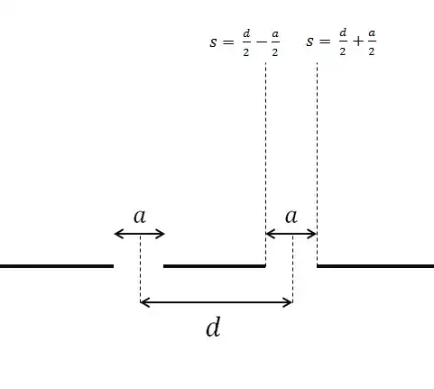

Case 3: Double-Slit Pattern
Each slit has width $a$. The distance between the center of each slit is $d$.
Double-slit
Just as before, we split the wave in each opening into $N$ waves, respectively. For each opening, $\Delta s = a / N$. As we send $N\rightarrow \infty$ for both slits, we obtain the integrals
$$ \int_{-\frac{d}{2}-\frac{a}{2}}^{-\frac{d}{2}+\frac{a}{2}}\frac{A}{a}e^{iks\sin\theta}e^{ikD-i\omega t}\;ds + \int_{\frac{d}{2}-\frac{a}{2}}^{\frac{d}{2}+\frac{a}{2}}\frac{A}{a}e^{iks\sin\theta}e^{ikD-i\omega t}\;ds. $$
After evaluating the integrals, performing some serious trig acrobatics, and simplifying, we obtain
$$ \frac{Ae^{ikD-i\omega t}}{ak\sin\theta/2}\left[ \sin\left(k(\tfrac{d}{2}+\tfrac{a}{2})\sin\theta\right)-\sin\left(k(\tfrac{d}{2}-\tfrac{a}{2})\sin\theta\right) \right].$$
We can hatch open this expression by applying sine addition formulas and getting cancellation. This yields
$$ \frac{Ae^{ikD-i\omega t}}{ak\sin\theta/2}\cdot 2\cos\left(k\left(\tfrac{d}{2}\right)\sin\theta\right)\sin\left(k\left(\tfrac{a}{2}\right)\sin\theta\right). $$
As before, the wavenumber is $k = 2\pi/\lambda$, so now the expression equal to
$$ \frac{Ae^{ikD-i\omega t}}{(\tfrac{\pi a\sin\theta}{\lambda})} \cdot 2\cos\left(\tfrac{\pi d\sin\theta}{\lambda}\right)\sin\left(\tfrac{\pi a\sin\theta}{\lambda}\right) $$
and this is
$$ \underbrace{2A\frac{\sin\left(\tfrac{\pi a\sin\theta}{\lambda}\right)}{\left(\tfrac{\pi a\sin\theta}{\lambda}\right)}\cos\left(\tfrac{\pi d\sin\theta}{\lambda}\right)}_{\text{Amplitude}}e^{ikD-i\omega t}. $$
By squaring the amplitude, we obtain
$$ I(\theta) = 4A^{2}\frac{\sin^{2}\left(\tfrac{\pi a\sin\theta}{\lambda}\right)}{\left(\tfrac{\pi a\sin\theta}{\lambda}\right)^{2}}\cos^{2}\left(\tfrac{\pi d\sin\theta}{\lambda}\right). $$
