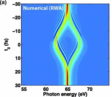

OK, so finally, and just because I can, I'll include here a shameless plug to the fact that Autler-Townes splittings are now essentially measurable on real time, with the splittings appearing and disappearing as the light pulse strengthens and then decays, as compared with the pulse you use to observe the absorption, so you can now think about measuring things that look like this,
where you're seeing (a numerical simulation of) the splitting induced by a $\lesssim 10$-cycle-long pulse of near-IR, probed by a broadband extreme-UV pulse that's a good deal shorter than the period of the IR (yes, that's a thing that you can make and measure), scanning over a delay between the two pulses.
This is a growing field, known as attosecond transient absorption spectroscopy, and there's a lot we can say at the moment and even more that we'll be able to say in the coming years in terms of how things like Autler-Townes splittings grow and develop in the natural timescales of atoms.
The picture is of course more complicated (and for example it seems, in the picture above, that the RWA might not cut it at all even in regimes where the splitting is in the optical regimes (!)), so I'll just leave for further reading the paper where that figure came from,
and a second paper along the same lines,
  • Time-domain perspective on Autler-Townes splitting in attosecond transient absorption of laser-dressed helium atoms. M Wu et al. Phys. Rev. A 88, 043416 (2013).
