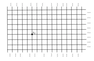

The lattice $L$ is semi-infinite (i.e. has a boundary on the left) and is visualized below:

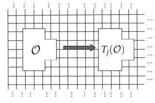

We can then imagine taking a local observable $\mathcal O$ (whose support is visualized below:) and forming the translate $T_j(\mathcal O)$ of the observable $j$ units into the bulk:
If we imagine taking the expectation value of such an observable in the limit that $j$ tends to infinity, we recover the expectation value of that same observable, but evaluated in the full plane. This is the thermodynamic limiting value of the observable, and the rate of approach is known: \begin{align*} \langle T_j(\mathcal O)\rangle-\langle T_\infty(\mathcal O)\rangle\sim\,\,\, O(e^{-j/\zeta})\,\,\,\,\,\,\,\,\,\,\,\,\,\,\,\,\,\,\,\,\,\,\,\,\,\tag{1}\\ \end{align*} where $\zeta$ is the correlation length in the bulk model. This is the first statement that you wished to prove:

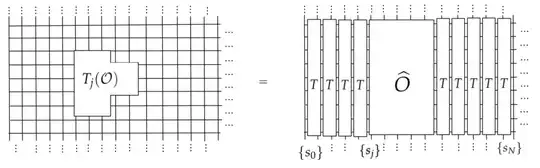

I will give a sketch of the proof of (1). We begin by rewriting the partition function in terms of the transfer matrix, which acts on the Hilbert space of configurations of a single column in the lattice: \begin{align*} Z&=\lim_{N\to\infty}\sum_{\{s_0\},\, \{s_N\}}\, \langle \{s_0\}|T^N|\{s_N\}\rangle,\,\,\,\,\,\,\,\,\\ &\,\,\,\,\,\,\,\,\,\,\,\,\,\,\,\,\,\,\,\,\,\,\,\,\,\,\,\,\,\,\,\,\,\,\,\,\,\,\,\,\,\,\,\,\,\,\,\,\,\,\,\,\,\,\,\,\,\,\,\,\,\,\,T:=e^{-\beta \sum_jJ_x\sigma^x_j\sigma^x_{j+1}}\cdot e^{-\beta \sum_jJ_y\sigma^z_j}\\ \end{align*} Here, $\{s_0\},\{s_N\}$ denote configurations of spins on the boundary column and bulk column, respectively. If we have a local observable in the semi-infinite plane, then its value may be expressed in terms of the transfer matrix $T$ as follows: enter image description here In equations: \begin{align*} \langle T_j(\mathcal O)\rangle&=\lim_{N\to\infty}\frac{\sum_{\{s_0,s_N\}}\langle\{s_0\}|T^j\,\widehat O T^{N-j} |s_N\rangle}{\sum_{\{s_0\}}\langle\{s_0\}|T^N|\{s_N\}\rangle}\\ \end{align*} Immediately, visually we can see why the boundary is irrelevant: in the high-temperature phase of the model, $T$ is gapped and has a unique maximal eigenvector. Performing the half-infinite thermodynamic limit replaces $T$ with projection onto its maximal eigenvector, which we denote by $|GS\rangle$: \begin{align*} T^j=|GS\rangle\langle GS|+O(e^{-j/\zeta}) \end{align*} where $1/\zeta$ be the gap between the largest and second-largest eigenvalues of $T$. Therefore, substituting this into the observable, \begin{align*} \langle T_j(\mathcal O)\rangle&=\frac{\sum_{\{s_0,s_N\}}\langle\{s_0\}|GS\rangle \langle GS|\,\widehat O|GS\rangle\langle GS |s_N\rangle}{\sum_{\{s_0\}}\langle\{s_0\}|GS\rangle \langle GS|\{s_N\}\rangle} + O(e^{-j/\zeta})=\langle GS|\widehat{\mathcal O}|GS\rangle+O(e^{-j/\zeta}) \end{align*} $$$$ Let's compare this with the result we would have obtained in the bulk: \begin{align*} \langle \mathcal O\rangle_\text{bulk}&:=\lim_{j\to \infty}\langle T_j( \mathcal O)\rangle = \langle GS|\widehat{\mathcal O}|GS\rangle. \end{align*} By subtracting this from the finite-$j$ result, this finishes the proof of (1) in the simple case $T>T_c$, by showing that the characteristic range of boundary effects on local observables is equal to the bulk correlation length.
Similarly, using this transfer matrix convergence argument, one can establish:
(2) As $N\to \infty$, the overlap of the ground state of the periodic system and the ground state of the open system goes to 1.
(3) As $N\to \infty$, the reduced density matrix in the bulk does not depend on the boundary conditions.
Again, as in the proof of (1), we replace $T^j \sim |GS\rangle \langle GS|$ for $j$ sufficiently large. Again, the key ingredient here is the convergence of the powers of the transfer matrix $T^j$, which loses any "memory" of finite-size effects/ordering as $j\to \infty$.

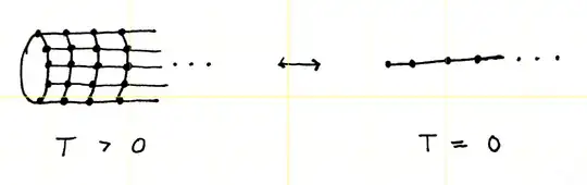

Having sketched a quick proof of the intuition "boundary effects do not matter" in a classical setting, it is actually trivial to generalize this to quantify the boundary effect in a quantum groundstate. We actually do not need to redo the proof; instead, we port the proof to the quantum setting by utilizing the quantum-classical correspondence, which states, roughly, that
$$ \{\text{$d+1$-dim'l Classical system at $T>0$}\}\leftrightarrow \{\text{$d$-dim'l Quantum system at $T=0$}\}$$
Therefore, to prove (1-3) for a quantum groundstate, it suffices to utilize the quantum-classical mapping. For example, for the case of the 1+1D transverse-field Ising model (TFIM), we apply the Suzuki-Trotter transformation with time-step $\Delta \tau>0$ to the quantum partition function $$Z=\lim_{\beta\to \infty}\text{tr}(e^{-\beta H_{TFIM}}),$$ which produces a family of effective actions $\{S[\Delta\tau]\}_{\Delta\tau}$ describing statistical correlations of a discrete Ising field on a cylindrical spacetime lattice. The family of effective actions is: $$$$ \begin{align*} S[\Delta\tau]\underset{\,\,\Delta\tau\to \,0\,\,}{\sim} \sum_{j\tau}(J[\Delta\tau]\,s_{j\tau}s_{j+1\tau}+J_\perp[\Delta\tau]\, s_{j\tau}s_{j\tau+\delta\tau})\,\,\,\,\,\,\,\,\,\,\,\,\,.\\ \end{align*} Of course, the boundary effect in the quantum model is then precisely the boundary effect in the 2D classical model, which we bounded in the arguments above (using the transfer matrix).
