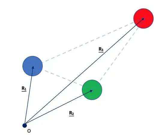

Let's consider the following strange, highly asymmetric tri-atomic planar molecule that I came up with, as an example, which allows me to treat a more general case):
my test molecule
For the moment, imagine there are no electrons in the system; just the three (different) nuclei which I have given different colours (blue, green and red for sites 1, 2 and 3 respcetively) which have charges $Z_1$, $Z_2$ and $Z_3$ respectively.

Yes, those are molecular orbitals, but they're not great at their job. For starters, you should really allow the orbitals from different centres to contribute with different weights: $$\phi^{a}(\vec{r}) = c_1\,\psi^{1}_{100}(\vec{r}) + c_2\, \psi^{2}_{100}(\vec{r}) + c_3\, \psi^{3}_{100}(\vec{r}).$$ Similarly, there's nothing stopping you from having multiple single-center orbitals contributing to the same molecular orbital, such as e.g. $$\phi^{a}(\vec{r}) = \left(c_1\,\psi^{1}_{100}(\vec{r}) + b_1\,\psi^{1}_{200}(\vec r)\right) + c\, \psi^{2}_{100}(\vec{r}) + c_3\, \psi^{3}_{100}(\vec{r}),$$ or in its more general form $$ \phi^{a}(\vec{r}) = \sum_{k,n,l,m}c^k_{nlm}\,\psi^{k}_{nlm}(\vec{r}). $$ In general, moreover, you really want to use this opportunity to add in spin into the system now, rather than later, so you form what's known as spin orbitals: you add a label $i$ for spin into your coordinates $\mathbf x=(\vec r,i)$, and you choose a basis of spin states $\sigma=\{\alpha, \beta\}$, getting you to the form $$ \phi^{a}(\mathbf{x}) = \sum_{k,n,l,m,\sigma}c^k_{nlm\sigma}\,\psi^{k}_{nlm}(\vec{r})\sigma(i). $$
