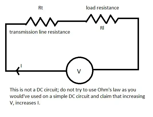

We aren't increasing the voltage across the transmission line. We are increasing the voltage of the source. The following image should clear your doubts.
The above diagram is an oversimplification of real world transmission lines and load. However, the above diagram is adequate enough to show where the question asker has made a mistake without complicating the answer.
Let the resistance (or impedance) of the transmission line be $R_t$
Let the resistance (or impedance) of the load (the devices used by industries, homes, etc) be $R_l$
Let the R.M.S voltage drop (potential difference) across the transmission line be $V_t$
Let the R.M.S voltage of the source be $V$
Let the R.M.S current through the transmission line be $I$
From Ohm's law, we have:
$$I = \frac{V}{R_t + R_l}$$
The total power consumed by all processes is given by
$$P_{total} = VI$$
The voltage across the transmission line is given by:
$$V_{t} = IR_{t} \tag{1}$$
The power dissipated by the transmission line is given by:
$$P_t = \frac{V_{t}^2}{R_{t}}$$
Since $I$ is reduced, the voltage across the transmission line is reduced (deducible from equation $(1)$). Therefore, $\frac{V_{t}^2}{R_{t}}$ also reduces. Thus, we are saving power.
