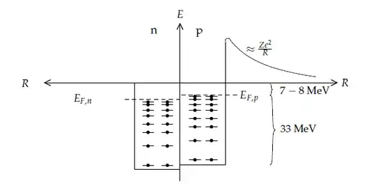

In my nuclear physics lecture we learned about the "fermi gas modell" of a nucleus with which I have some problems. First the potential for the nucleons is shown in the picture below and it makes somewhat sense to me.
potential as shown in lecture
But now the lecture goes on and says, we use the model of the free nucleon gas. Why does that make sense? There is a potential so the nucleons aren't free at all. To me it looks much more similar to a particle in a box for example. So first question: What das the free nucleon gas have to do with this potential?

  1. "As spin-1/2 particles they naturally obey Fermi-Dirac statistics. It is assumed that the nucleon, inside those constraints imposed by the Paul I principle, can move freely inside the nuclear volume" Povh Particles and nuclei. Basically the potential is flat and nucleons are free inside the nuclei
