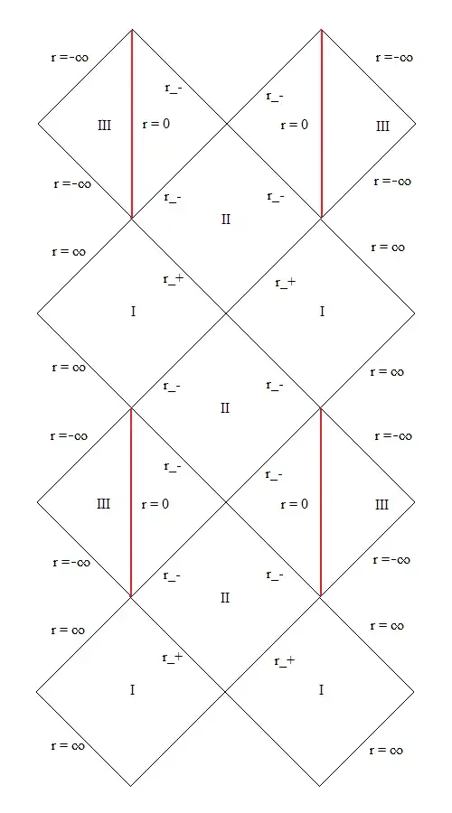

The Kerr, Kerr-Newman and Reissnor-Nordstrom metrics have time-like singularities. I include a large image of this below. This is the "ideal" situation for the eternal black hole. It also assumes the black holes in the opposing exterior regions I are completely entangled with each other. Susskind and Maldacena have illustrated how this corresponds to two black holes composed of EPR pairs. In this case the singularity at $r~=~0$ is a repelling sort of field.
The physical black hole has some departures from this ideal. The first problematic issue is with the inner horizon $r_-~=~m~-~\sqrt{m^2~-~a^2}$. It is coincident with $r~=~\infty$ or ${\scr I}^+$ which means an observer crossing this horizon encounters all possible radiation than entered the black hole. This is a Cauchy horizon, named for its structure similar to Cauchy sequences, and represent a sort of radiation wall. This appears to have singular properties. In addition, the Susskind-Maldacena result may be correct, but a black hole here could have been made form EPR pairs in a vast number of other black holes. This means that crossing the inner horizon might be a bit like being crushed in a "quantum garlic press"; every particle in your body gets sent into a different nontraversable bridge for each black hole. That would be rough. This means the inner horizon, which is a split null horizon, could be indistinguishable from a spacelike horizon in the Schwarzschild metric.
