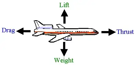

(b) In the discussion of aerodynamics in particular, there are approximately ten gajillion diagrams that look like this:
It would be hard to make sense of this diagram if you were considering weight to be a scalar.
