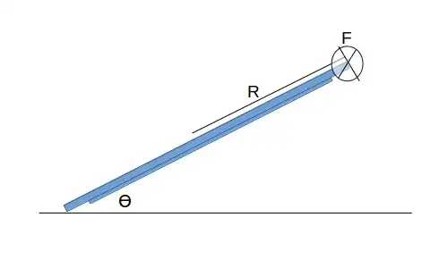

This is a common phenomenon that I observe whilst preparing a meal. Assume that we have a plate of diameter $r$ and we drop it when there is an angle $\theta$ between it and the table and we also apply a force $F$ at the side of the plate.
Suppose that the gravitational acceleration is $g$ how can we determine this plates "wobbling" frequency, how this frequency depends on time and when would this motion stop?
cross section of the plate

The frequency of the wobbling plate (or the spinning coin) is an interesting problem. We can make certain idealized assumptions to compute the frequency as a function of angle of tilt; as the plate loses energy through friction, the angle of tilt will decrease and this will affect the frequency.
The problem is known as "Euler's disk", and a detailed analysis of the motion is given on this page - the conclusion is that the rate of rotation as a function of angle $\theta$ is given by
$$\omega = \sqrt{\frac{4g}{r\sin\theta}}$$
Which makes sense given our observation that the rate of wobble goes up as the plate settles down.
The damping is a difficult question - according to wikipedia the problem was addressed in a Nature article by Moffatt, who showed that the spinning time is indeed finite, and scales with the third power of the initial angle. It's not clear to me whether that is the definitive answer - there is some disagreement on whether the dissipation is due to viscous effects or rolling friction.
