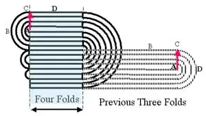

Thanks to gerry for the key word (given in a comment above). I can now make my above guess more concrete. The limit on the number of folds (for a given length) does follow from the necessary curvature on the fold. The type of image you see for this makes it clear what's going on
Fold diagram
For a piece of paper with thickness $t$, the length $L$ needed to make $n$ folds is (OEIS) $$ L/t = \frac{\pi}6 (2^n+4)(2^n-1) \,.$$ This formula was originally derived by (the then Junior high school student) Britney Gallivan in 2001. I find it amazing that it was not known before that time... (and full credit to Britney). For alternate folding of a square piece of paper, the corresponding formula is $$ L/t = \pi 2^{3(n-1)/2} \,.$$
Both formulae give $L=t\,\pi$ as the minimum length required for a single fold. This is because, assuming the paper does not stretch and the inside of the fold is perfectly flat, a single fold uses up the length of a semicircle with outside diameter equal to the thickness of the paper. So if $L < t\,\pi$ then you don't have enough paper to go around the fold.

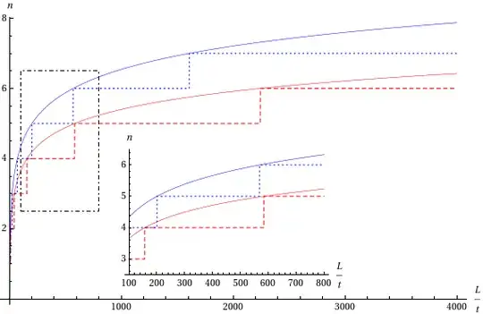

These formulae can be inverted and plotted to give the logarithmic graphs
Number of folds given a length
where $L$ is measured in units of $t$. The linear folding is shown in red and the alternate direction folding is given in blue. The boxed area is shown in the inset graphic and details the point where alternate folding permanently gains an extra fold over linear folding.
You can see that there exist certain length ranges where you get more folds with alternate than linear folding. After $L/t = 64\pi \approx 201$ you always get one or more extra folds with alternate compared to linear. You can find similar numbers for two or more extra folds, etc...
Looking back on this answer, I really think that I should ditch my theorist tendencies and put some approximate numbers in here. Let's assume that the 8 alternating fold limit for a "normal" piece of paper is correct. Normal office paper is approximately 0.1mm thick. This means that a normal piece of paper must be $$ L \approx \pi\,(0.1\text{mm}) 2^{3\times 7/2} \approx 0.3 \times 2^{10.5}\,\text{mm} \approx .3 \times 1000 \, \text{mm} = 300 \text{mm} \,. $$ Luckily this matches the normal size of office paper, e.g. A4 is 210mm * 297mm.
The last range where you get the same number of folds for linear and alternate folding is $L/t \in (50\pi,64\pi) \approx (157,201)$, where both methods yield 4 folds. For a square piece of paper 0.1mm thick, this corresponds to 15cm and 20cm squares respectively. With less giving only three folds for linear and more giving five folds for alternating. Some simple experiments show that this is approximately correct.

I believe there is a physical limit for folding, due to the very low extensibility of paper (i.e. you cannot stretch paper). Take the sketch posted by @Simon:
Observe that the inner layer (previously top layer) will incur compression while the outer layer (previously bottom one) will incur extension. This is giving rise to a bending rigidity force. This bending rigidity can be reduced if the layers of paper are allowed to slide relative to one another, however as you add more layers this is not possible anymore because there is another fold at the other end of the paper stack.
Let's assume that the inner radius of curvature of the fold is zero and that there is no relative sliding at all of the paper layers. Then the midline of the inner layer at the fold has length $t\pi/2$ (where $t$ is the thickness), while the outer one has length $(N+1) t\pi/2$ (where $N$ is the number of folds). Thus the strain is as $N+1$, and will reach at some point the maximum strain that the paper your sheet is made of can allow: you'll be either prevented from folding, or you will tear the paper if you're able to apply sufficient force.
In practice, what you do to increase this limit is that you make a "loose" fold for the first few folds: this allows to palliate for the inextensibility of paper and provides some additional length to allow the outer bends (at the price of small wrinkles in the inner ones).
Using a material more extensible than paper wll also allow for more folds.

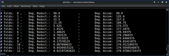

I made this printout of how many angular degrees are consumed per fold for the required range that would signify a valid fold, being 180 degrees turn of the paper, with each step consuming one-half of the remaining range from the fold before it.
One fold is 180 degrees of angular torsion, and the layers of the fold converge on the fold to reduce the range of additional tortion by one half for each fold of the paper.
The known limit, which is 11 folds before it becomes impossible to fold a piece of paper again, is the first in the series that is a repeating decimal of the prior value, and so we can see that a limit point is reached where progress becomes immpossible or extremely difficult.
The common limit that people usually report getting is 7 folds before they cannot fold a piece of paper or any other material any further, and in my series here that is the first step in which the net gain in torsion is a fraction of one, and efficiency is lost at this point so it is the initial beginning of the loss of efficiency in torsion achieved per halving, and so it becomes exponentially more difficult at that point to achieve the next fold.
